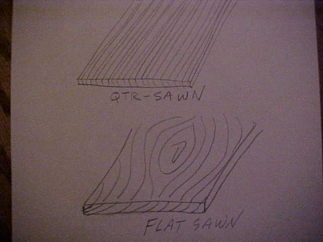

A lot of mahogany has 'ribbon' figure; well quartered African stuff can't really be found without it, to be honest, and I suspect it's very common in well-quartered honduran as well.
Quartered wood has the grain lines running perpendicularly (at 90 degrees to) the faces of the board you plan to use. Look carefully at the endgrain to see the cut, although it's not always easy with mahogany in particular. Don't confuse sawmarks with it. Look at a spruce top end-on, engrain side. That's one of the easiest woods I know of to see end-grain in, and should show you what quartered wood looks like.
Some of the honduran I've got has faint 'white' lines along some of the grain. If you want the wood for backs and sides, get quartered wood. Ditto for necks, although with 2.5" stock you could simply get perfectly flatsawn wood (grain running parallel to the top and back surfaces), flip it 90 degrees and laminate it into neck blanks, which would make it quartered again (grain going from surface to back).
The reason we like quartered wood is that it's more dimensionally stable and stronger than any other cut, less likely to warp. Backs and sides don't have to be quartered, although they should be if possible, but necks really should be in my opinion. Then again, almost every single maple Fender neck ever made was slab (flat) sawn, so..
As for Pecan making good tonewood...tap and find out, maybe try it. Various fruit woods have been used successfully in various instruments over the centuries

PostPosted: Sun Jan 23, 2005 1:11 pm
